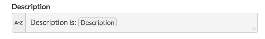

Sometimes the value may not be present and you can just add some alternate values:
Here are some examples
In this example, regardless of the value of description, there will be some value that will be there.

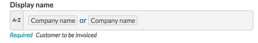

This example shows, how you could pick values from one of two sources. The first one from a successful search, and the second one from a created record if the search failed.

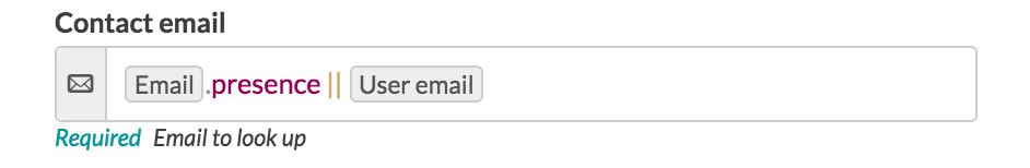

In this example, it use the value from the first email input if it is present, otherwise it gets it from the second input.
