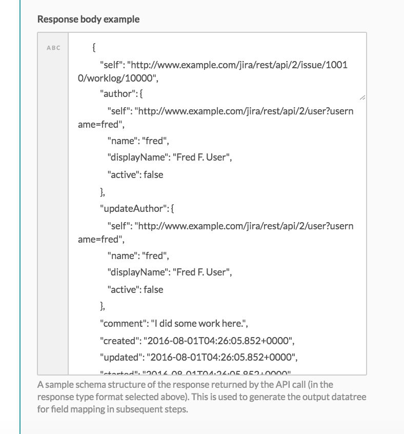

Most REST APIs, such as QuickBooks and JIRA, are structured in JSON and users can directly copy the sample JSON responses from the API documentation and paste in the Response body example. You can further customize the schema to ensure it picks up your custom fields.
(an example of JSON code in Response body example)
